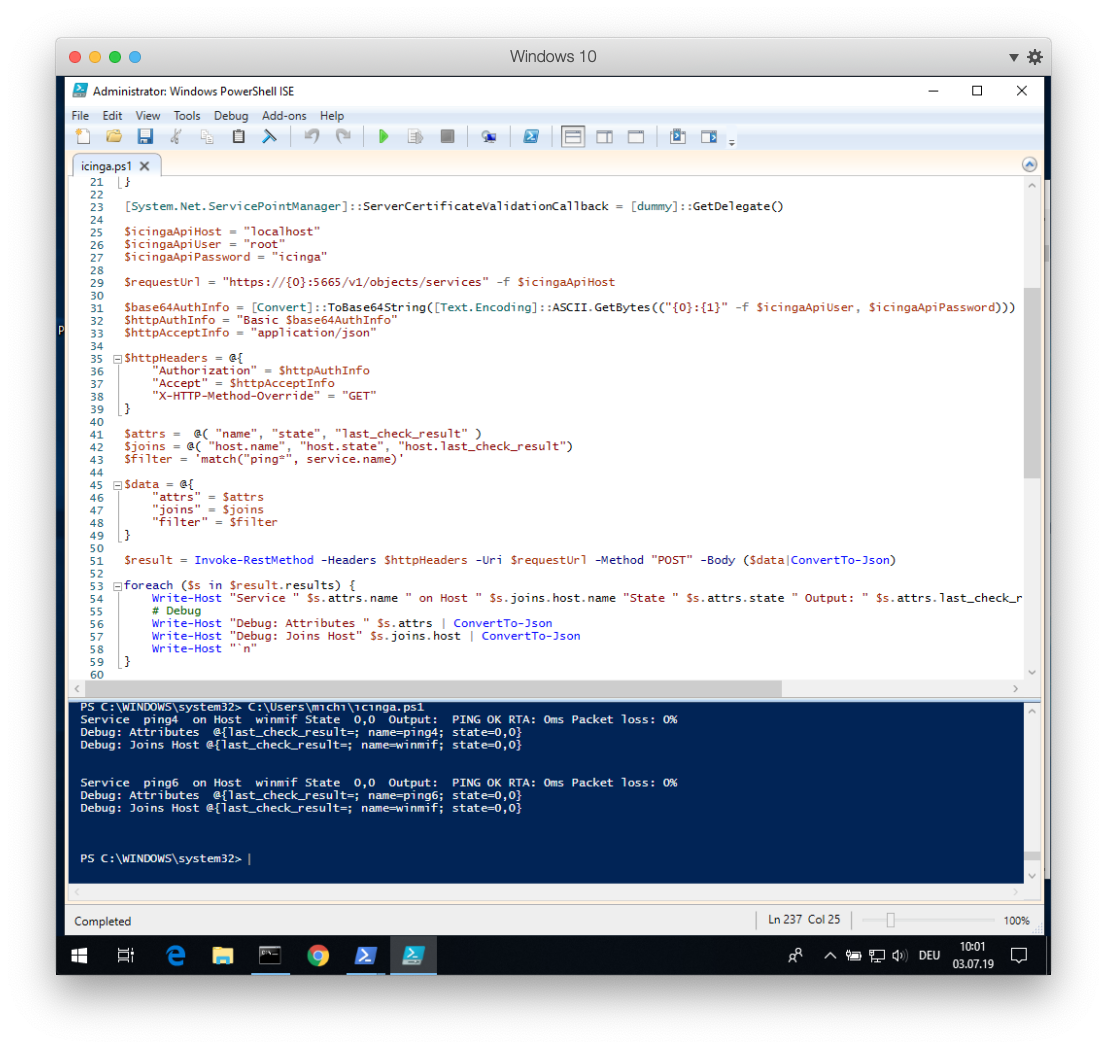

Example API Client in Powershell
This example compares the given certificate with the certificate from icinga2 for a trusted connection. More info: https://stackoverflow.com/a/58494718/9397788
Invoke-RestMethod with PUT is buggy with Powershell 3.0. So we need at least Powershell 4.0. https://stackoverflow.com/questions/18278977/powershell-v3-invoke-restmethod-headers

Run the Powershell ISE as administrator, and execute the script as you change it.
Icinga 2 API Windows Powershell ISE Script
Alternatively, save the code and run it in Powershell:
.\icinga.ps1
