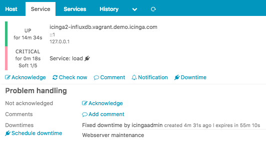

Scheduling a downtime
You can schedule a downtime either by using the Icinga 2 API action schedule-downtime or by sending an external command.
Fixed Downtime
If the host/service changes into a NOT-OK state between the start and end time window, the downtime will be marked as in effect and increases the downtime depth counter.

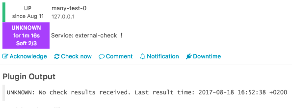

Best practice is to define a dummy check_command which gets executed when freshness checks fail.
apply Service "external-check" {
  check_command = "dummy"
  check_interval = 1m
  /* Set the state to UNKNOWN (3) if freshness checks fail. */
  vars.dummy_state = 3
  /* Use a runtime function to retrieve the last check time and more details. */
  vars.dummy_text = {{
    var service = get_service(macro("$host.name$"), macro("$service.name$"))
    var lastCheck = DateTime(service.last_check).to_string()
    return "No check results received. Last result time: " + lastCheck
  assign where "external" in host.vars.services
References: get_service, macro, DateTime.
Example output in Icinga Web 2:
Icinga 2 Freshness Checks
